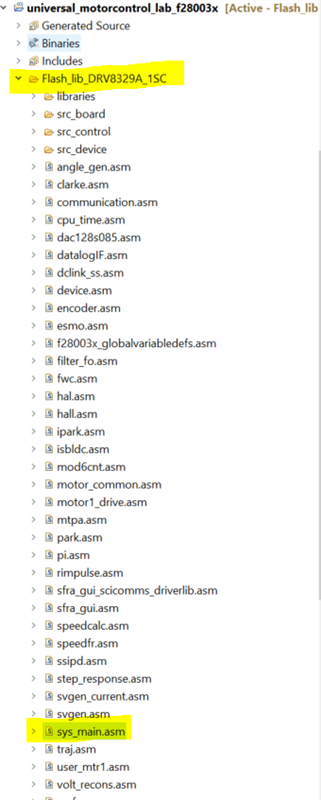

    Are you verifying before you do so that flagEnableSystem = 1?
    If that was the case nothing would work without CCS debug. The HWREGH call to set the flag enable bit or read back variable data works but none of the C syntax links symbols to below noted addresses in modules that are not part of the original TI build. Though custom modules virtual file paths/folder can exist under SDK under libraries folder or UMC folder, so path is not the issue. Somehow the compiler is skipping over pointers to the struct members not linking them to the data word.
     Example of failed compiled code:
        MOTOR_Vars_t *obj = (MOTOR_Vars_t *)motorHandle_M1;
    Fails: motorHandle_M1.flagEnableRunAndIdentify = true;
    Works: HWREGH(0x0000074B) = 0x1;
    Fails: if((obj->flagEnableRunAndIdentify == true) && (obj->flagRunIdentAndOnLine == true))
    Works: if((HWREGH(0x0000074B) == 0x1) && (HWREGH(0x0000074C) == 0x1))
    Fails: obj->flagEnableRunAndIdentify = true;
    Works: HWREGH(0x0000074B) |= 0x1;

  • Hello again,
    This is an interesting set of problems that I've not seen before. I'll consult with some colleagues- in the meantime, I do have a couple follow-up questions and comments.
    1. I didn't realize from prior posts that the code was failing to compile. Are there compilation or linker errors being logged in the problems window?
    2. Import a fresh Universal Motor Control Lab example into the workspace. Compare the project properties between the two.
      1. 'CCS General'
        1. Are the project options the same in your project, accounting for differences in device?
      2. 'CCS Build'
        1. 'C2000 Compiler'
          1. Are the 'Processor Options' and 'Optimization' options the same in your project, accounting for differences in device?
        2. 'C2000 Linker'
          1. Are the 'Basic Options' and 'File Search Path' options the same in your project?
    3. If CCS thinks that the code is being compiled correctly and your linker options all look correct, the fastest way I can think of offhand to see exactly what's happening on the backend is to take a quick glance at some assembly files.
      1. Once you've enabled the option to keep the assembly file, re-build the project.
      2. In project explorer, navigate to the generated build folder:
      3. Ctrl-F "SYSTEM_Vars_t"
      4. There should be 2 occurrences in this file. Between them, each variable in the struct is listed.
      5. Is everything there that you expect to be there?

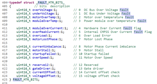

  • About Startup failure fault: The struct member used to set the fault bits runMotorMonitor() are different from the reported struct member in CCS debug expressions tab. Using the same struct member FaultMtrNow.bit in runMotorMonitor() to test the faults inside SCI interrupt context must use FaultMtrPrev.bit or several faults cannot ever be cleared by setting motorVars_M1.flagClearFaults = 1. Oddly CCS debug uses FaultMtrPrev.bit to indicate individual faults. HID GUI uses Prev.Bit to test, turn LED widgets red or green.
    What that has to do with enabling GPIO CMD switch in project build is baffling.
    // Motor Startup Failed
    if( (obj->Is_A < objSets->stallCurrentSet_A)
    && (obj->speedAbs_Hz < objSets->speedFailMinSet_Hz))
       if(obj->startupFailTimeCnt > objSets->startupFailTimeSet)
    obj->faultMtrNow.bit.startupFailed = 1;
    obj->startupFailTimeCnt = 0;
    /* set fault flag */
      bFaultSet = true;
    else
      obj->startupFailTimeCnt++;
    else if(obj->startupFailTimeCnt > 0)
      obj->startupFailTimeCnt--;
    /* clear fault flag */
      bFaultSet = false;

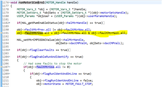

    Addressing your posts and queries in no particular order:
    • FaultMtrNow is the the active monitor. FaultMtrPrev is a latch that indicates whether or not a selected fault has ever happened- this is also useful information long-term, but isn't necessarily going to be helpful debugging individual faults, and further is never actually reset.
    • Note that generally, 'disabling' the PWM is typically performed in the labs in this SDK (and in most implementations overall, in my experience) by setting a trip to disable the final output. When a trip occurs, the PWM does not stop running, the ADC (triggered by the PWM) therefore does not stop triggering, and the ISR (triggered by the ADC) therefore does not stop running.
    • I had not realized you were also referencing the MotorWare InstaSPIN examples- good to know. It's definitely important to check the differences between those examples and the newer, more up-to-date Universal Lab before implementing the concepts they utilize.
    • I find that in these examples, while the system waits for the user to set a flag to begin actively responding, the peripherals and interrupts typically continue to execute and the output or action is simply blocked from propagating.
    Jason Osborn
  • Hello again,

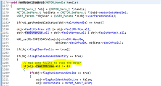

    Forgot to mention one thing. In addition to FaultMtrPrev and FaultMtrNow, you'll notice that there's FaultMtrUse and FaultMtrMask.
    Not every fault actually stops the motor from running. With Boolean logic, FaultMtrUse = (FaultMtrNow & FaultMtrMask). The rest of the FOC code looks at FaultMtrUse when determining if a fault has occurred.
    So, in summary;
    • FaultMtrNow is a list of all currently active faults
    • FaultMtrPrev is a list of every fault that has ever happened since we started executing the code
    • FaultMtrMask is a constant bit mask over the faults struct, allowing us to only use a selected subset
    • FaultMtrUse = FaultMtrNow & FaultMtrMask, meaning it's every currently active fault from our selected subset only.

    To clarify what I was trying to say,
    • runMotorMonitor() sets FaultMtrNow
    • runMotor1Control() uses FaultMtrNow to set FaultMtrUse
    • runMotor1Control() also uses FaultMtrUse to determine whether or not to stop the motor
