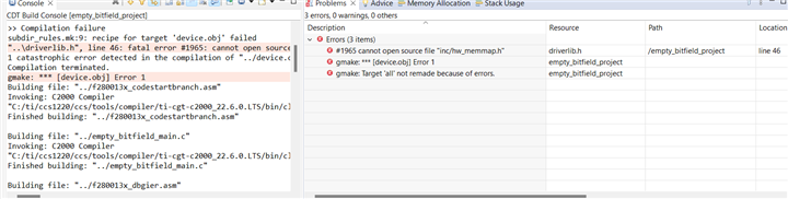

Part Number: TMS320F2800137
i used an empty bitfield project, added comm
on and header includes when i'm building the project, getting error
Bit field project do not use the driverlib APIs. Are you trying to call the driverlib APIs from the bitfield project?
If so, then you will have to add the header files for the driverlib as Include paths in the Project settings
Best Regards
Siddharth
