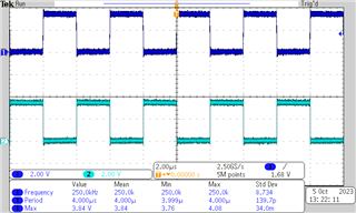

    So the EPWM1 sync out is sync in for EPWM2 yet there is inherent delay in the PWM module. Yellow one is EPWM1A and Magenta is EPWM2A.
  • Hi Manish,
    Here is my code snippet, the only thing I changed was the TBPHS value to be 250, so it produced a 180 degree phase shift.

    This is the results I am seeing on the scope: Can you confirm?
    Here is also a register export of ePWM1 and 2 configurations. Please compare with your registers to see if there is anything different.
