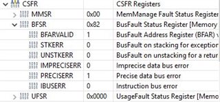

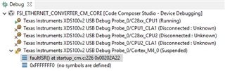

  •      why I am trying to reset the CM Core is mainly due to entering Hardfault ISR (looks like Preciserr), so If I can track down  why it hangs in this ISR I could omit resetting the CM Core which would solve the problem, I have tried to track down the reason for this from my end without any success, I am attaching the relevant snippets of the registers at that point of time, I hope with your expertise you could see directly what is going wrong and give a solution. we couldn't simply single step through the code, because the code runs without any problem for couple of minutes before it hangs, and the successful run time is variable and like 5 to 6 minutes on average.Ethernet frames are also successfully recieved on the PC end untill the Hardfault happens.
    If u need more info kindly let me know.

    Do you mean that every time it runs successfully only for  5 to 6 minutes before it causes a hard fault? Is this repeatable everytime.
    Will take a look at the code and get back to you.
    Best Regards
    Siddharth
    Yes, it runs without any problem for some minutes (on average 5 to 6 mins) before it causes the Hard fault (Ethernet frames are received on PC  until hard fault occurs) and this is repeatable every time.

  • I was thinking that it worked fine but only in some cases, you had to reset the core.  If it is repeatable and works only for few minutes, then it looks to be a memory handling issue.  Are you seeing any memory leak or stack overflow which might be causing the hard fault?

  • Hi Siddharth,
    Thank you for your response and valuable insights into the issue we're facing with our project. I appreciate your assistance in helping us resolve this matter.
    I've taken screenshots of the stack usage window, memory allocation window, and the project property settings for stack size . However, I'  m unsure about how to pinpoint the exact issue based on these screenshots alone.
    Would it be possible for you to provide some guidance on how to interpret the information from these screenshots and where to look for potential memory leaks or stack overflow issues, and how to correct them? Additionally, if there are any specific thresholds or patterns that we should be aware of, it would be incredibly helpful to know.

  • Nirojan,
    Few things that you can check
    1. Stack Pointer and stack size -  Check if the stack pointer is still in valid stack region when the hard fault occurs
    2. Try increasing the heap size .
    3. Check for the function call history and see which function causes the hard fault.
    This will help in narrowing down the issue.
