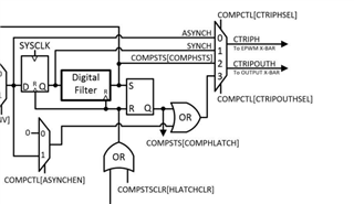

I am trying to modify the TIDM-02000 and output the CMPSS3 High side output to GPIO24, but it is not output. Are there any other registers to set in the program below?

  • A few things to check.
    1. F280049c controlCARD settings. There is a switch on the board that select the location for GPIO24 on the HSEC connector.
    2. The CTRIPOUTH configuration in the CMPSS module, specially if you are using the digital filter.
    3. XBAR/GPIO configuration. This looks ok to me. I check using sysconfig and it looks ok. Sysconfig generated code:
