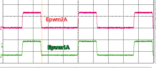

I want to achieve a phase shift between 2 Epwm channels like a below waveform (which obtain from the simple time base epwm channel): [ syscfg. Example downloaded form the TI example library]
I have downloaded another HRPWM example (syscfg) and successfully runs, but unable to establish a phase shift between two HRPWM channels (epwm1A & epwm2A).
I have learned phase shift setting from TI example library (example name: epwm_ex3_synchronization) and extended its phase shift setting to HRPWM configuration but failed.
I don't understand the basic phase shift logic between HRPWM channels and simple Epwm channels.
From the TI example library, I didn't find the HRPWM synchronization example, where I can learn about it.
Could you plz check my HRPWM phase shift code which is generated by syscfg tool.
Please, Help me to solve this HRPWM phase shift issue. Thank you.

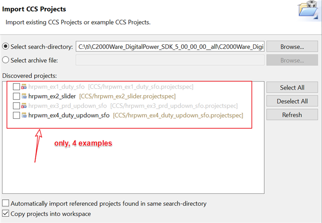

  • Hello Mr. Whitney,
    I have downloaded the following SDK file and checked. This file is also included the 4 HRpwm examples, and non of them discuss the phase shift.
    The following examples are shown below with path:
    (C:\ti\C2000Ware_DigitalPower_SDK_5_00_00_00__all\C2000Ware_DigitalPower_SDK_5_00_00_00\c2000ware\driverlib\f28004x\examples\hrpwm)
    I used the example (hrpwm_ex3_prd_updown_sfo), and modified into the up-counter and then try to create a phase shift on the following reference base example (epwm_ex3_synchronization), but it didn't work.
  • Sorry, I should have been more specific--within the SDK instead of going into the c2000ware folder, look at the example projects in solutions. You'll see folders in there for tidm_02002 and tidm_020013 projects I had mentioned earlier. You can then open up the HAL files where the PWMs are configured and see what methods are used to enable the phase shift.
    Whitney
