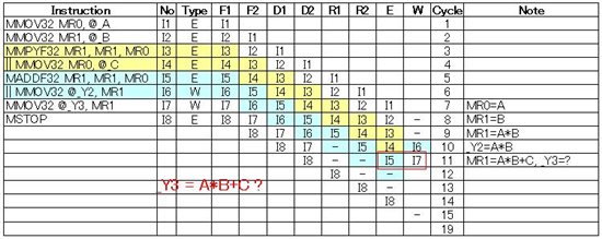

I  made diagramming Pipeline Activity  for 8 instructions as following:
 I don't sure that _Y3 = A*B + C. Can you tell me about this matter ?
    The parallel instructions are a single instruction. You only have 6 instructions in this case:
    If im correct, the sequence of operations are:
    OPERATION, PHASE
    MR0 = A, I1 -> E
    MR1 = B,I2 -> E , MR0 = C, I3 -> R2
    MR1 = A*B, I3 -> E
    MR1 = A*B+C, I4->E
    Y2 = MR1, I4->W
    Y3 = MR1, I5->W , MSTOP, I6->E
            I don't understanding about the pipline activity for parallel instruction. Could you tell me about diagram pipline activity in this case?

  • I dont have a diagram handy for parallel instructions. My recommendation is to single step through this code on a device that has a CLA and to observe the CLA registers.
    The following video talks about how you can do that:
    http://focus.ti.com/general/docs/video/Portal.tsp?lang=en&entryid=0_dm3z6wz1
    Also if you wish to profile CLA code, CCS4 has a cycle clock built in. While debugging you can go to Target->Clock->Enable Clock to start the cycle count. You can reset it any point through the same menu.
    Hope this helps
