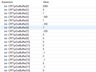

Now coming to the problem: First call to this function gives correct results but the next call gives wrong results and this continues for all successive call i.e a call giving correct results and the next call giving incorrect results.
Please find below the results captured from the watch window of debug:
Correct results:
Incorrect results:
Note that I am calling the function every 5 seconds so that the watch window has enough time to refresh. I have been trying to troubleshoot it my self but no success so far. I am using C2000Ware 4.0.2 and the compiler version is  22.6.0.LTS. Let me know if more information is needed.
  • Asad,
    Just so I understand clearly - is it just the 1st call that gives correct results, and all future calls give incorrect results? Or alternate calls give correct results?
    Does the exact same approach that you've described above work correctly for the 64-pt CFFT case?
    Did you try running the 128-pt CFFT example present in the VCU2 DSP library in C2000Ware?
    Sira
