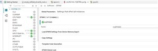

I use several peripherals in the project, which initializations are managed by SysConfig. For instance I use one PWM Module:
Let's add an other one:

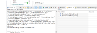

And build the project:
Everything is OK. But if I set the RAM configuration as Active, the building cannot be done:
The message is:
#10099-D program will not fit into available memory, or the section contains a call site that requires a trampoline that can't be generated for this section. placement with alignment/blocking fails for section ".text" size 0x1c00 page 0.  Available memory ranges:
