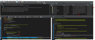

    I think you are referring to issue 2): what I claim is that the value rtY.IO_Msg_out.id is correctly refreshed in my expressions monitor, but I cannot assign it to a variable (i.e. currentID) or pass it directly to a function. So, in SendCmdToDriver(...) , before xQueueSend, I can see it is always 0, thus QueueSend is never done.
    With some more trials, I get the address of rtY.IO_Msg_out.id and I put it in currentID changed into a uint16_t pointer and I checked it is pointing to the wrong address:
    How can it be?

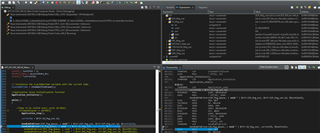

  • Regarding the currentID not getting the right address. can you share the corresponding assembly instructions?

    About the second issue, here the instructions:

  • Hi Veena,
    I got the point: I had multiple definitions of the same custom typedef in different files.
    The E2P_Msg_out like IO_Msg_out are custom data type structures that I changed in my application but I did not changed in another common header file and, even though I had #ifndedf instructions to avoid re-definition, I think that some compiling issues happened, causing the weird behaviour.
