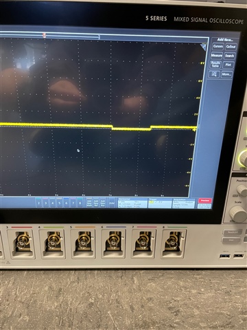

  • When you say. "The reset does clear the program from the DSP", what exactly it means. Program is loaded into non volatile flash and that should not get clear unless user clears it using flash API. Right ? Also I was requesting to provide the snapshot of oscilloscope with XRSn toggle. I think in this case you need to connect the CCS and run through this sequence to see where CPU is stuck after XRSn

  • I am using blinky as a test program, when the reset pin is toggled it stops blinking. However, it will not let me reprogram the DSP unless power is cycled.  The toggle reset process works on the F28335 DSP just not this F280049C. Here is the reset toggle on the oscilloscope:
    The goal is to be able to program and reset this device over serial so code composer is not needed.
