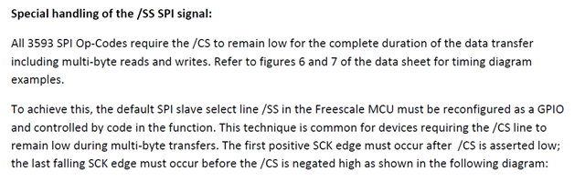

    As of now ,I am controliing the chip select manually as suggestly in the application note:
    Could you suggest the correct way to send/receive multiple bytes.
    I was looking at the C2000ware library and not sure which function does this in spi.h header.
