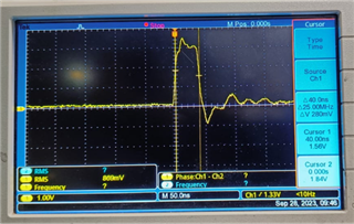

From the data sheet/TRM of TMS320F28379s controller, in the attached image the EXTSYNCOUT pulse duty is “pulse stretched(8 PLLSYSCLK)”. Which means as per my Configuration (PLLSYSCLK  = 200MHz). My EXTSYNCOUT pulse width period will be of  40 nano Seconds
PLLSYSCLK  = 1/200MHz = 5 nano seconds,
8 x PLLSYSCLK  = 8 * 5nS = 40 nano Seconds.
And I’m getting the pulse width exactly for 40nS(MHz) once in the 50uSeconds , attached the image below, (Oscilloscope Captured)
But in my application, I need the PWM_SYNC_IN pulse width to be at least 50% of period, So that I can use the proper filter to eliminate the Glitches in the Sync pulse for my hardware configuration.

  • Hi Rajamurugan,
    Pulse stretching cannot be done through the EPWM module, but you can look into implementing the CLB to create this behavior. While you cannot route the actual EPWM6 SYNC_OUT pulse to the CLB, you could use the TBCTR = 0 or TBCTR = PRD events of the master PWM to start a counter in the CLB that would emulate a stretched sync pulse. The CLB could drive an output GPIO signal high (the start of your extended sync pulse), and the counter can be set to last 50% of the duty cycle. When the timer expires, the output would go low again (the end of the extended sync pulse). This CLB output signal can be routed to the slave PWM as the SYNC_IN signal. Please note that this signal chain may produce a slight delay as it passes through these modules which you could also use phaseshift to correct for. In terms of board design: if you wish to use only a single-ended GPIO to issue the sync signal between the master and slave, take care to avoid cross talk and noise from nearby fast-switching signals. If these controllers are near to each other, this is less of a concern, but longer GPIO traces can increase noise. Let me know if you have further questions here.
