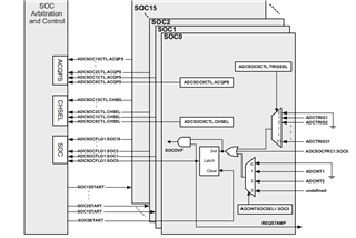

In the diagram shown, there are 3 sources of triggering the SOC, the SOCFRC, the ADCINT and some PWM triggers. My doubt is if SOCFRC is not cleared after the first time, then we donot need to wait for ADCINT to start the 2nd cycle of conversion again (which is desirable in my case as I need to start the 2nd cycle of conversion only after all the SOCs in my 1st cycle has been completed). As it is an OR gate before so any bit in the input, if high, will trigger an output high and hence SOC will begin. So the SOCFRC must be cleared somehow, so as to ensure that my ADCINT1 only triggers the 2nd cycle of SOC. \

    3. I have initialised the SOCFRC bit and set it to 1 for all SOCs in my initialization of ADCs file. I am a bit confused regarding how will it be cleared. The reason being, I am using ADCINT1 for triggering my conversion start. But the first start of conversion needs to be started by software forcing and once it starts as and when my conversion gets completed, the ADCINT1 will be triggered and again the conversion will start from SOC0. So the need for SOCFRC to be set 1 is one time. I am not clearing the SOCFRC bit anywhere in my code, so is it cleared by hardware somehow after one time use?
    The ADCSOCFRC register is not meant to be initialized; that is the register that you write to when you want to trigger a conversion start using software. First you must configure ADCSOCxCTL to configure the sample window, channel selection and trigger source. Then you write 1 to the desired SOC bit in ADCSOCFRC to force a software conversion. Reads of this register will always return 0. ADCINTx is the ADC interrupt signal that gets set at the end of conversion (or at the end of the sample+hold phase/start of conversion phase if ADCCTL1.INTPULSEPOS = 0).
    Using ADCINTx to trigger a conversion is intended for when you want one SOC to begin immediately after another ends. In this case, you configure ADCINTSOCSEL1/2 to specify which ADCINT will trigger the desired SOC. The ADCINT itself must be associated with the end of a particular SOC by writing to ADCINTSEL1N2.
