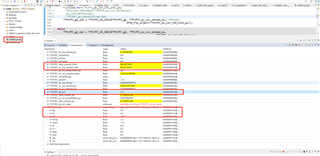

1. In the TMS320F137 environment, run the PFC (TIMD0208) program and perform Experiment 2 on the DC current loop. When running the PI algorithm, it was found that no matter how the values of Kp and Ki parameters are modified, the calculation result (TTPLPFC_gi_out) will not change. TTPLPFC_ Gi_ Out always equals 1 (as shown in the figure below), may I ask why?

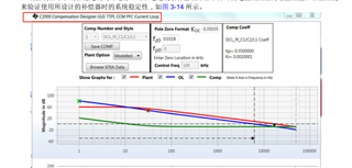

2、请问一下,下图软件怎么获取,可以提供一下连接嘛?

  • Hello Luo
    It is possible that TTPLPFC_gi_out may be updated some where else after being updated by the current loop. If you want the true value of TTPLPFC_gi_out from the current loop, add a new variable immidiately after TTPLPFC_gi_out in the current loop like below:
    and then look for this new variable in the expression window.
    Amir
  • Hello, expert!
    1、I tried according to what you said, and the result is still the same. The redefined variable value is 1, indicating that the result calculated by PI has always been 1, and the breakpoint shows that the result calculated by PI is also 1
    2、May I ask, how can the software in the following figure be obtained? Can you provide a connection?

  • Hello Young
    #define TTPLPFC_GI_PI_KP (float) 0.3496503407
    #define TTPLPFC_GI_PI_KI (float) 0.0020000510
    how did you make these values zero? I dont think you can change these values in setting.h file. After changing these values, did you rebuild the project? I believe these values update to original values after building because values in the setting.h file comes from mainsysconfig. I am not sure why are u getting gi_out as 1. looks like it is saturating. Can you elaborate your experiment condition?
    Amir
  • hi
    Firstly, we will migrate the TIDM02008 program to the F2800137 environment without porting the mainsysconfig file. Instead, we will simply migrate the source and header files, as shown in the following figure:
    secondly
    #Define TTPLPFC_ GI_ PI_ KP (float) 0.3496503407
    #Define TTPLPFC_ GI_ PI_ KI (float) 0.0020000510
    The two macro definitions can be configured with values through setting. h. They have been successfully configured to 0 and will not have any impact after compilation, as shown in the following figure;
    thirdly
    The experimental conditions were carried out according to the steps and conditions of Experiment 2 in the experimental guide book.
    fourthly
    No, I'm not going to_ Out becomes 1, regardless of how the values of Kp and Ki are adjusted gi_ Ou is always 1, which is definitely incorrect.
    fifthly
    Is there any channel to send my program to you? This is more convenient for you to guide us.
    Best regards!
    yong
