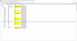

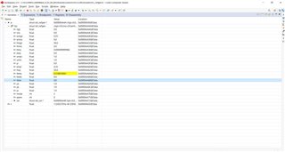

  • Hello Sira,
    I've adjusted the parameter of DCL_SET_CONTROLLER_PERIOD() as recommended, but I haven't noticed any changes so far. I've captured snapshots of the values of 'p' within DCL_runRefgen() from DCL_refgen.h at 5 different intervals, and I've attached them.
    It's possible that there's something I'm missing or not understanding correctly.
    Thank you,
    Aloba.
  • So the mode looks correct (2 = REFGEN_SINE), and the theta values seem to be updating as expected. But the ya is 1 in each case, so that's wrong.
    Do you have the TMU enabled in your project? Can you place a breakpoint there, look at the generated code in the disassembly view and see whether SINPUF32 is generated?
