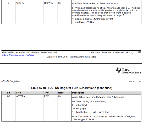

  • I believe these two fields will be used for the software force of output A, is this correct?
    I have seen two settings one-time software force and the other is continuous software force. Can you clarify the difference?
    Also please let me know about the deadtime considerations like you mentioned.
  • Hi Anurag,
    Yes, you are correct that those two fields of the AQSFRC register will be used to software-force an Action Qualifier on output A of the EPWM signal.
    In terms of the difference between the one-time and continuous: The one-time software force means that when you trigger the AQ via software by writing a '1' to the OTSFA, the output will perform the action specified in ACTSFA a single time and will be cleared automatically after the action takes places on the output signal. Since it auto-clears, the action lasts for one cycle and then resumes normal AQ activity. Contrastingly, a continuous software force means that the action specified in AQCSFRC register fields is output on the PWM signal without ceasing (i.e. 'continuously') until that bit is cleared or overridden by another submodule's actions.
