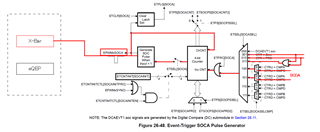

I'm attempting to trigger the latching of the position counter's value with the ADCSOCA, but the value of QPOSSLAT remains at 0 without updating.
Is there any part of the configuration that is incorrect, or are there any other registers that should be checked?
EQep1Regs.QEPCTL.all=0x9258
EPwm1Regs.ETSEL.all= 0x3a03
QEPSTROBESEL = 0x002
ADCSOCOUTSELECT = 0x001
EPwm1Regs.ETSOCPS.all=0x0101

    The configuration for eQEP and ePWM seem correct. Could you verify that your PWM signal is being output correctly on pins? I see you have
    EPWMxSOCA being generated on event time-base counter equal to period and EPWMxSOCB enabled when event time-base counter equal to zero.
    Do you have set the TBPRD for ePWM? Have you set TBCLKSYNC for the ePWM modules to start the TBCTR for the PWM modules? If the PWM module is not running, there will be no events being generated.

  • Hi Ryan,
    Thank you for your comment.
    I have confirmed that the ADCSOCA signal is being output using OUTPUTXBAR5. However, even when changing the settings from X-Bar to eQEP, QPOSSLAT does not get updated.

  • Hi Ryan,
    Setting EQep1Regs.QEPSRCSEL.bit.QEPSSEL to 1 resulted in the update of QPOSSLAT. However, the explanation for QEPSSEL was not found.
    How is QEPSSEL being used? Can you provide a block diagram?

  • Hi Yuta,
    Apologize for the confusion, I am going to see if we can add a block diagram for this as it is an important step in configuring the Position Counter Latch.
    I will provide an update once I get confirmation on this functionality. Thank you for bringing this to our attention.

  • Hi Yuta,
    Apologize for the late response. You are correct and I have taken action to note this in the TRM.
