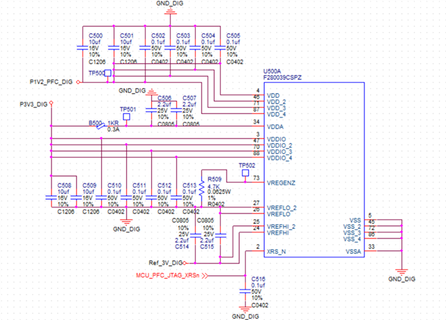

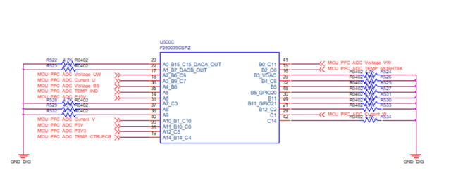

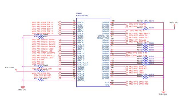

TMS320F280039C: Occasional abnormal issues with chip power on
Part Number: TMS320F280039C
When the chip is powered on, there may be occasional situations where the program does not boot in (especially when the board is left standing for a period of time), and it can still function normally after being powered on again. I'm not sure what the problem is. Can you help me check if the hardware design is correct?
