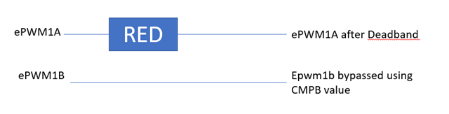

Dear Texas Instruments Team,
At the moment, I am developing the software to control the LLC converter. As you already know during the startup asymmetrical PWM is required for a first few PWM cycles, and later the symmetrical complementary PWM mode is needed. In the attached Figure, first 6 PWM cycles shows an example for PWM pattern during the startup procedure for LLC.
Figure 1: PWM pattern for startup procedure.
Here are some notes for first six PWM patterns:
1st PWM cycle – only low side MOSFET shall be turned on. High side MOSFET is turned off. PWM is not working in complementary mode.
2nd PWM cycle – both, low side and high side MOSFETs shall be turned off. PWM is not working in complementary mode.
3rd PWM cycle – low side and high side MOSFET operate at complementary mode where duty cycle for high-side MOSFET is smaller compared to the low side MOSFET.
4th PWM cycle - low side and high side MOSFET operate at complementary mode where duty cycle for high-side MOSFET is smaller compared to the low side MOSFET, but the ration between low side and high side duty cycle is now changed. Duty cycle for high side MOSFET is increased and duty cycle for low side is decreased.
5th PWM cycle - low side and high side MOSFET operate at complementary mode with the symmetrical PWM pattern – duty cycle for both PWM signals is 50 %.
6th PWM cycle - low side and high side MOSFET operate at complementary mode with the symmetrical PWM pattern – duty cycle for both PWM signals is 50 %.
I attached the main.c file used to test the startup PWM pattern. Inside the PWM interrupt, the PWM parameters are updated for every new PWM cycle. To make everything transparent and synchronous, the global load option is selected to update all the required registers at the same time. The problem which occurs is with the start of 3rd PWM cycle where smaller spike occurs at the start of the PWM cycle. This is not spike caused by the interference or neither it is introduced by the bad measurement setup. My assumption is that it happens because the Dead Band Submodule is bypassed in 2nd PWM cycle and in the 3rd PWM cycle is enabled. But I do not understand why because the global load is enabled. Can you please tell me why is this happening and how to solve an issue with the spike. This behaviour is not acceptable.

/* Set Dead-Band settings for Complementary Mode */
HWREGH(EPWM1_BASE + EPWM_O_DBCTL2) = 0x4U; // All writes and reads to bits [5:0] of the DBCTL register are shadowed
EPWM_setDeadBandCounterClock(EPWM1_BASE, EPWM_DB_COUNTER_CLOCK_FULL_CYCLE);
EPWM_setRisingEdgeDeadBandDelayInput(EPWM1_BASE, EPWM_DB_INPUT_EPWMA);
EPWM_setRisingEdgeDelayCount(EPWM1_BASE, 25U);
EPWM_setDeadBandDelayPolarity(EPWM1_BASE, EPWM_DB_FED, EPWM_DB_POLARITY_ACTIVE_LOW);
EPWM_setFallingEdgeDeadBandDelayInput(EPWM1_BASE, EPWM_DB_INPUT_EPWMA);
EPWM_setFallingEdgeDelayCount(EPWM1_BASE, 25U);
HWREGH(EPWM1_BASE + EPWM_O_AQCSFRC) = 0x5; // Force PWM1 A and B to LOW state
