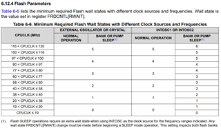

  • But out of curiosity, I want to know that if it really takes too much time to load from flash to RAM?
    If you mean you want to load from Flash to RAM, you can do this very simply (you can follow some of the Flash examples provided in C2000Ware). But if you're asking why we don't do it by default, this is more of something that depends on the customer; some customers want to execute from Flash because if the device loses power, the program can still execute when powered on without having to worry about spending time copying memory over. It really just depends on preference, although I highly recommend programming to Flash and then loading functions/application to RAM for speed benefits.
    why delta is this? (getting 1.5us instead of 1us in FLASH mode).
    Is there mentioned in manual or document?
    Flash is slow to access, this is a fairly universal concept. However, our devices run much faster than the Flash operates, so wait states are introduced to properly access data. This is indeed documented in the device's datasheet (for all devices). For the F28003x:
