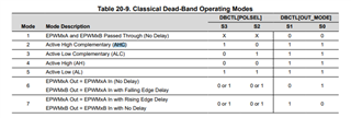

I want to use an epwm of c2000 controller. I have a custom algorithm, where I have a pulse state (on/off) of the inverter is the output of my logic. So that is why, I don't want to use the Compare function and EPWM1A and EPWM1B compare value updating. But I wish to use the dead band feature of EPWM. So, at what point I need to update the pulse output of my logic. For example, ISR rate is 4kHZ TBPRD is 12500. I want to turn on the top switch and bottom switch to off of a leg of inverter. Here, I don't have a modulating wave, that is why I want to skip the CMPA CMPB functionality. Please suggest me the function in EPWM that helps me to use dead band.

    I am building an custom algorithm for inverter switching. Where, my outputs are ON/OFF states of the inverter. i.e., it is not a modulating wave and no need to compare the with the triangular. But, I want to use the deadband functionality of the epwm. That is why, i want to know where I need to update the EPWM BASE after the Action qualifier or some where ?and how to use it is my question. Here I am attatching a screen shot of the custom algorithm. and EPWMA and EPWMB sequence i am getting from my algorithm with an ISR rate of 4kHZ. I just want to provide deadband to the outputs. The updation happens with ISR rate.is it possible to bypass or disable AQ functionality and to use deadband directly.
    Thank you
  • Hi Dharmendra,
    Let me know if the following is correct:
    • Your EPWM should have a constant duty cycle of 50%
    • output B should always be inverted from output A
    The following diagram in the TRM shows the common operating modes of the dead-band module:
    This table shows the necessary settings for each of the above modes:
    The following diagram shows how the dead-band module operates with the appropriate registers and bitfields:
    If you are using SysConfig, you can select one of the classical operating modes and then simply configure your rising edge and falling edge delays. I would recommend trying one of the epwm dead-band examples in C2000Ware to understand how the dead-band module works.
    Let me know if you have any further questions.

  • Hi jones,
    1.The EPWMA and EPWMB are complementary.
    2.But those are not of 50% duty cycle. It is variable duty cycle.
    I have referred the reference manual and the sysconfig examples also. I understood that, I have to change the Action qualifier output or deadband input epwm.
