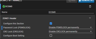

The problem is that now I wanted to lock passwords in order to make them not visible through any access. I wanted to do it by changing :
But when I try to load the  program with this change in PSWDLOCK I have this error:
C28xx_CPU1: If erase/program (E/P) operation is being done on one core, the other core should not execute from shared-RAM (SR) as they are used for the E/P code. Also, CPU1 will be halted to determine SR ownership for the CPU which will run the Flash Plugin code, after which CPU1 will be set to run its application. User code execution from SR could commence after both flash banks are programmed.
C28xx_CPU1: Error during Flash programming (Flash algorithm returned error code). FMSTAT (STATCMD on some devices) value = 48. Operation Cancelled (0).
C28xx_CPU1: File Loader: Memory write failed: Unknown error
C28xx_CPU1: GEL: File: C:\Users\mserrataco\Documents\01 SOFTWARE\02_SW_BootloaderCAN_DualCore\cpu1\Debug_CPU1\bootloader_cpu_cpu1.out: Load failed.
In Flash Settings I set the actual LINKPOINTER at 0x20 and the custom passwords:
So these are my questions:
1. As enabling PSWDLOCK changes from 1 to 0 last four bits, I thought it was always programmable. Is that true?
2. If not, is it possible to make something to this device to secure this password or it is impossible from now?
Thank you

  • Hello Hareesh,
    thanks for you answer. According to question 2,  secured my device but the passwords are visible if I connect through JTAG (I can connect with "Wait boot mode" status and without introducing password in CSMPSWD of Flash Settings). So, with my secured device:
    • I can connect through JTAG
    • I can read passwords at adress 0x78028 --> this is what I don't want
    • I can't read the rest of memory (all addresses show 0x0000) without introducing correct CSMPSWD in flash settings
    • I can't load new .out without introducing correct CSMPSWD in flash settings
    So my question was related to second item, I didn't want to be able to read passwords through JTAG without introducing the correct CSMPSWD.I thought I would be able to change PSWDLOCK at the end of my debug process in order to block this passwords, but I don't know if it is already possible or not.
    Thank you

                I believe I understand the issue. I have a feeling you are stuck with the same issue as https://e2e.ti.com/support/microcontrollers/c2000-microcontrollers-group/c2000/f/c2000-microcontrollers-forum/1271793/tms320f28379d-problem-with-programming-otp_pswdlock.
    Understandable, since you have programmed the passwords but not enabled security yet, which is done by writing to the PSWDLOCK register.
    Expected since the secure resources are not unsecured until the Password Match Flow (PMF) is executed
    This is expected as well. You cannot program the Flash until you have unsecured it.
    Did you program the whole OTP in one attempt or did you try to program the security settings first and the PSWDLOCK later?
  • Hareesh,
    the first time I programmed the device was with this dcsm.asm file , so I think I programmed all the security settings including PSWDLOCK (even it was 0xFFFFFFFF).

  • Hi Etiam,
    Have you tried all of the following before attempting to program the .out file that has PSWDLOCK enabled?
    • Unlock the zone via the On-Chip flash tool before programming new .out file that has PSWDLOCK enabled.
    • Power-cycle the device before programming .out file
    • Make sure both CPUs have been reset and are not running before programming new .out file
    Thank you,
    Luke
  • Etiam,
         You need to exclude programming the PSWDLOCK when you programmed the other zone settings. Even though you did not change the value of the PSWDLOCK register, the tool updates the corresponding ECC, which then would prevent you from writing to the PSWDLOCK again. You have two choices:
    1. Exclude PSWDLOCK initially.
    2. Write everything (zone settings and zone header) in one go.
