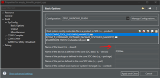

  • Thanks this did resolve my issue. I also dug into why it was not working in the first place taking what i learned from you. This is what i found.
    In Project Properties under Build>SysConfig>Basic Options with build configurations CPU1_LAUNCHXL_RAM and CPU1_LAUNCHXL_FLASH.
    the board field is blank.
    putting /boards/LAUNCHXL_F280049C into that field fixes the issue as well
    Thank you for your help
