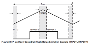

Hello, I'm new to programming on microcontrollers. I use one of your products: TMS320F28379D. I code on CCS. I'm looking to make a PWM signal.
I have configured the ePWM output, in up down count as well as a high period resolution with the SFO() file. My problem is as follows:
I've configured the Action Qualifier to set and toggle when TBCLK reaches Zero and then when it reaches the PRD period. I want to do this because I'm sure I'll have a duty cycle of exactly 50%. The problem is that when I set the qualifying actions to ZRO and PRD (instead of CMPA and CMPB) the HR period is not stable anymore and only varies roughly. Here's an extract from the code:
(*ePWM[j]).AQCTLA.bit.ZRO = AQ_SET;
 (*ePWM[j]).AQCTLA.bit.PRD = AQ_TOGGLE;
But the HR periode signal works perfectly with these lines of code, but it's not what I want:
(*ePWM[j]).AQCTLA.bit.CAU = AQ_SET;
 (*ePWM[j]).AQCTLA.bit.CAD = AQ_CLEAR;
Do you have any idea how to make the HRPWM for the period work with qualified actions on the ZRO and PRD?
