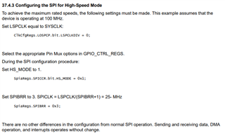

  • Hi Michel,
    While technically only GPIO 58-61 are configured for high-speed mode like you mentioned, since SPIA as a whole is in high-speed mode(HS_MODE = 1), it seems that it is possible to use GPIO57 when toggling between CS. As long as you are not also planning on toggling between SPISIMOA/SOMIA/CLKA, it should be okay. I would just make sure you are aware of the following information from the SPI TRM section related to this mode, if you aren't already:
