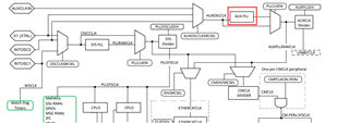

    What are AUXPLL and CLBCLKCTL.CLBCLKDIV? Are these part of CLB registers? How can the user set them in Sysconfig GUI?
    It looks like the F28003x doesn't have it explicitly laid out in the datasheet clocking diagram, but this is basically where AUXPLL comes from:
    I believe the CLBCLKDIV is in one of the System Control registers, but I can't seem to find it (the only other reference I see to it is the below table). I don't believe there's a way to configure them in SysConfig currently, but I will forward this to another expert to confirm.
