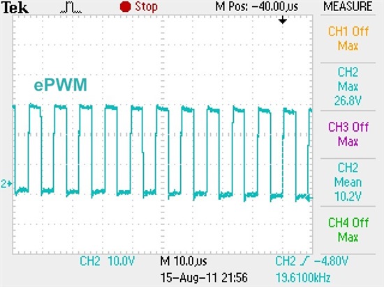

the following figure is about ePWM~

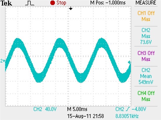

But it's sinusodal? why?

Please check the grounding of your scope. The sine wave appears to be around 60Hz AC.
