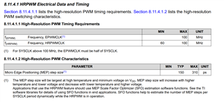

Hi team,
PWM characteristics MEP step size is about 150-310ps, if the PWM control accuracy is 3-6ppm?
Thanks.

Hi Enhui,
Yes, the HRPWM MEP step size is as specified in the datasheet with typical 150ps to max 310ps. Can I ask where you are getting the 3-6ppm?
