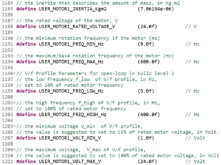

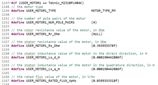

    First and foremost, I would verify that the motor-specific hardware parameters are correct. In the user_mtr1.h file, that's the following parameters:
    Most of these values can be found in the datasheet for the motor. Specifically, in the past, I've seen that a highly inaccurate value for USER_MOTOR1_INERTIA_Kgm2 can result in the estimator failing to function at all. Verify all of these parameters, but pay particular attention to that one.
    As for the 3 parameters you indicated in the second post, these parameters are used exclusively for Motor Identification in Build 4- they shouldn't impact performance in your system yet. Typically, they can be left at the default value. Tuning instructions for these can be found or derived from the InstaSPIN-FOC and IsntaSPIN-MOTION User's Guide (spruhj1i) if the identification process doesn't seem to work properly.
