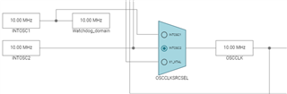

Selecting INTSOC2 as CLK source for SYSCLK and X1_XTAL for AUXCLK will fail CPU1 start because of the wrong used defines.
SysConfig selection:

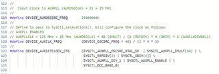

And the generated code:
Line 120 should use DEVICE_AUXOSCSRC_FREQ = 25MHz but instead it uses DEVICE_OSCSRC_FREQ = 10MHz.
