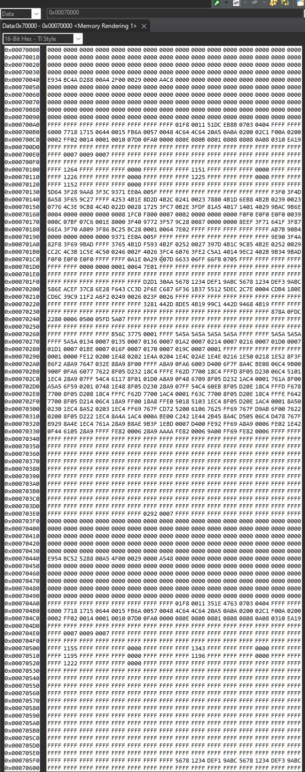

  • Hi Mateusz,
    Could you attach an image of the device that you are using?
    Thanks and regards,
    Vamsi
  • Also, please share the TI-OTP memory dump from the debugger memory window.

  • Hi Mateusz,
    Could you provide the requested info?
    Thanks and regards,
    Vamsi
  • Hi Vamis,
    I apologize for the late answer. Here is the requested information.

    5200 6106 7625 FF69 767F D9AB 6F00 7622
    0200 8F05 D222 1EC4 8A4A 1AC4 000A BE00
    C242 1E44 2B45 8A4C D505 06C4 D478 767F
    B929 8A4E 1EC4 761A 28A9 B8AE 9B3F 1EBD
    0007 D400 FE92 FF69 A8A9 0006 FE02 1E42
    0F44 6105 28A9 FFFF FE82 0006 28A9 AAAA
    FE82 0006 9A00 FF69 FE82 0006 FFFF FFFF
    FFFF FFFF FFFF FFFF FFFF FFFF FFFF FFFF
    FFFF FFFF FFFF FFFF FFFF FFFF 0292 0007
    0000 0000 0000 0000 0000 0000 0000 0000
    q

    Can you share your linker command file and map file?  You can remove any proprietary information from it.
    From the snapshot that you shared, I see that the flash driverlib is copied to RAM.  I would like to confirm whether the flash API itself is copied to RAM or not. Thank you.
    Best regards,
    Vamsi
  • Hi Vamsi,
    In my source file, I use #pragma CODE_SECTION directives to add FlashAPI functions to ".TI.ramfunc" program block.
    For example:
    #pragma CODE_SECTION(CallFlashAPI, ".TI.ramfunc");
    void CallFlashAPI(void)
        EALLOW;
        // This function is required to initialize the Flash API based on
        // System frequency before any other Flash API operation can be performed
        // Note that the FMC register base address and system frequency are passed as the parameters
        // This function must also be called whenever System frequency or RWAIT is changed.
        oReturnCheck = Fapi_initializeAPI(F021_CPU0_BASE_ADDRESS, CPUCLK_FREQUENCY);
        if(oReturnCheck != Fapi_Status_Success)
            Example_Error(oReturnCheck);
        // Fapi_setActiveFlashBank function initializes Flash bank
        // and FMC for erase and program operations.
        oReturnCheck = Fapi_setActiveFlashBank(Fapi_FlashBank1);
        EDIS;
    That directive allocates all my functions from my custom flashAPI source file.
    Every flashAPI driver lib function which is inside my function is allocated in FLASH_BANK_0.
    Here is the part of the .map file from the project.
    .TI.ramfunc
    *          0    00081000    000001c5     RUN ADDR = 00008000
                      00081000    00000049     driverlib.lib : flash.obj (.TI.ramfunc:Flash_initModule)
                      00081049    0000003c     Fapi_UserDefinedFunctions.obj (.TI.ramfunc:writeVector)
                      00081085    00000031     Fapi_UserDefinedFunctions.obj (.TI.ramfunc:FlashAPIEraseSectorIDVector)
                      000810b6    0000002c     driverlib.lib : flash.obj (.TI.ramfunc:Flash_setBankPowerMode)
                      000810e2    00000023                   : flash.obj (.TI.ramfunc:Flash_setWaitstates)
                      00081105    0000001d                   : flash.obj (.TI.ramfunc:Flash_setPumpPowerMode)
                      00081122    00000019     Fapi_UserDefinedFunctions.obj (.TI.ramfunc:CallFlashAPI)
                      0008113b    00000018     driverlib.lib : flash.obj (.TI.ramfunc:Flash_disableCache)
                      00081153    00000018                   : flash.obj (.TI.ramfunc:Flash_disablePrefetch)
                      0008116b    00000017                   : flash.obj (.TI.ramfunc:Flash_enableCache)
                      00081182    00000017                   : flash.obj (.TI.ramfunc:Flash_enablePrefetch)
                      00081199    00000016                   : flash.obj (.TI.ramfunc:Flash_enableECC)
                      000811b7    00000006     Fapi_UserDefinedFunctions.obj (.TI.ramfunc:Example_Error)
                      000811bd    00000004     driverlib.lib : sysctl.obj (.TI.ramfunc)
                      000811c1    00000004     f28003x_usdelay.obj (.TI.ramfunc)

    I don't know if it could be a problem. I didn't operate on the FLASH_BANK_0 just on BANK_1 where there is no FLASH api function.
    Mateusz
