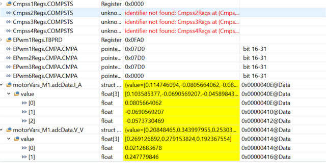

  • Hello @Jason Osborn
    Thanks for your response.
    1)Have you adjusted the copied .cmd files &. project spec file?
    yes, because we used existing .cmd files for F2800157.
    2) any warning or error?
    No
    3)have you set 'motorVars_M1. flagEnableRunAndIdentify=1' once initialization is complete?
    yes
    4)Please check if the following variables are showing correct values.
    . motorVars_M1. adcData.I_A
    . motorVars_M1. adcData.V_V
    Not sure the read values are correct attached Screenshot.
    5)Does the following variables have any values at all after you have set flagEnableRunAndIdentify ? it should
    No, when I set Ref Sped as 60 its start with 1.723 and drop to zero.
    6)Does the following variables have any values at all after you have set flagEnableRunAndIdentify ? it should
    . motorVars_M1.faultMtrUSe.all ---> always zero
    Good point here is when enable LEVEL2 build motor running at 60HZ speed but speed in GUI Expression is always zero.
    Right now, Vdc bus voltage reading wrong values.
    when i set RPS to 9V its always showing 17.xx voltage
    when i set RPS to 30V its always showing 17.xx voltage
    I feel, the current and voltage offset are not correct.
