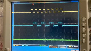

We are trying to make a SPI communication in F28335 device, and by sending the data from our TMS320F28335 SPI (MASTER) to external Slave device of HOLT INTEGRATED CIRCUIT HI-35850 (SLAVE) device board.
Here, We have configured the TMS320F28335 SPI device as a MASTER and HI-35850 as a SLAVE.
  • For this, we were trying to send the Arinc data which is a 32 bits by 4 iterations, since we have configured SPICCR.bit.SPICHAR for a 8-bit word.
  • We have captured and attached as a attachments Waveforms in 4-channel CRO with the SCLK, MISO, MOSI and CS.  But we were unable to see more than 16-clocks in the waveforms and the Chip select (CS) was getting de-asserted, but we need 32 clocks for 32 bit and we need your support on this.
  • And I had attached my C code below for SPI for this, along with Initialization and configuration in the module name Mcu1_Spi_initialization().

Please visit to my attachments of the Waveforms and SPI code.  And kindly suggest me, what need to be corrected.
  • Hi Chaya,
    Please double check that the clock phase and polarity between F28335 and HI-35850 align. Could you try changing the polarity bit to 1? If this doesn't help, just want to make sure I have all context- is there any other code involved in the sending/receiving of data for F28335? You are operating in non-FIFO, F28335 master mode, with no interrupts, correct?
    Allison
    1. Yes, we are operating in non-FIFO mode.
    2. TI F28335 as a MASTER mode.
    3. And no interrupts.
    Test Environment :
    • Host system (TI F28335 as the main controller) powered separately
    • ADK-35850  with HI-35850 powered together as a single assembly.
    Host SPI configuration (TI F28335):
    • Clearing SPI SWRESET to 0 for reset state, SpiaRegs.SPICCR.bit.SPISWRESET = 0;
    • Host as MASTER, SpiaRegs.SPICTL.bit.MASTER_SLAVE = 1;
    • Baud rate: 500 Khz, SpiaRegs.SPIBRR = 0x7F;
    • Transmitter enable, SpiaRegs.SPICTL.TALK = 1;
    • Configuring Host to Mode -‘0’, SpiaRegs.SPICCR.bit.CLKPOLARITY = 0; , & SpiaRegs.SPICTL.bit.CLK_PHASE = 0;
    • Host SPI 8-bit character, SpiaRegs.SPICCR.bit.SPICHAR = 0x7;
    • Clearing OVERRUN FLAG, SpiaRegs.SPISTS.bit.OVERRUN_FLAG = 1;
    • After these configuration, set SPI SWRESET to 1, SpiaRegs.SPICCR.bit.SPISWRESET = 1;
    Host SPI Bus pin Configuration (TI F28335):
    • Firstly we are enabling pull-up resistors for GPIO16 (MOSI), GPIO17 (MISO), GPIO18 (SCLK) & GPIO19 (SPISTE).
    • Set Asynchronous input for  GPIO16 (MOSI), GPIO17 (MISO), GPIO18 (SCLK) & GPIO19 (SPISTE).
    • Configured GPIO16 for MOSI, GpioCtrlRegs.GPAMUX2.bit.GPIO16 = 1;
    • Configured GPIO17 for MISO, GpioCtrlRegs.GPAMUX2.bit.GPIO17 = 1;
    • Configured GPIO18 for SCLK, GpioCtrlRegs.GPAMUX2.bit.GPIO18 = 1;
    • In order to keep SPISTE (CS) active throughout, configured GPIO19 for General Purpose I/O (GPIO), GpioCtrlRegs.GPAMUX2.bit.GPIO19 = 0;
      • GpioDataRegs.GPADAT.bit.GPIO19 = 0;
      • GpioCtrlRegs.GPADIR.bit.GPIO19 = 1; (for output)
    Interconnection between Host SPI (TI F28335) and HOLT HI-35850:
                    Test configuration details are below, please refer the Fig -2, Fig -3 and Fig -4 attached.
    • Host SPI MOSI (GPIO16) <-> HI-35850’s Serial Input (SI)
    • Host SPI MISO (GPIO17) <-> HI-35850’s Serial Output (SO)
    • Host SPI SCLK (GPIO18) <-> HI-35850’s Serial Clock (SCLK)
    • Host SPI SPISTE (GPIO19) <-> HI-35850’s Chip Select (CS)

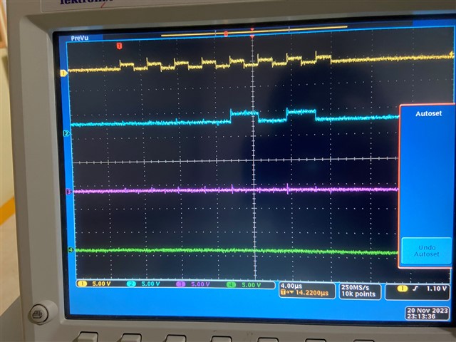

    Test Conducted:
    • Transmitted "0x0A" data on SO and in response awaited for data "0x01" from the HOLT board
    • Observed that the no. of clock pulses were restricted to only 8, even though CS continued to remain in active state (refer the Fig -1 attached) and no data received from the HOLT HI-35850.
    Queries:
                    Clarifications needed from you for below queries,
    1. Please confirm either our configuration is correct for SPI to operate in Mode "0"?
    2. Please clarify why the no. of clock pulses are getting restricted to 8 clock cycles, in spite of keeping the CS/ active?
    3. Please confirm whether the connection between Host SPI (TI F28335) and HOLT HI-35850 are correct?
    Requesting you to provide us your support on how to increase more than 8 clock pulses and get data received from the HOLT HI-35850.
     Thanks & Regards,
    Chaya
  • Hi Chaya,
    Thank you so much for the organized information here, it is very helpful. Your SPI F28335 and GPIO configurations look correct to me so far. This is the correct setup for operating in Mode 0, but can I ask if you did try setting the polarity bit to '1'? In other words, can you please try to test with the only change being setting polarity for F28335 to '1' so that F28335 is operating in 'Mode 1' instead of 'Mode 0'? I've seen a similar issue to this between another device and HI-35850 and want to make sure we check if this resolves the issue first since it's a quick change to implement.
    Please let me know if this is able to resolve the issue or if you see different behavior.
    Allison
  • HI .
    Thanks for your immediate response.
    As, per your suggestion we tried for Mode 0 and remaining modes also, combinations as given in the table below:
    MODES
    CLOCK POLARITY
    CLOCK PHASE
    GPIO-19
    Figure
    0
    0
    0
    General Purpose I/O
    Fig 1
    0
    0
    0
    CS
    Fig 2
    1
    1
    0
    General Purpose I/O
    Fig 4
    1
    1
    0
    CS
    Fig 3
    2
    0
    1
    General Purpose I/O
    Fig 5
    2
    0
    1
    CS
    Fig 6
    3
    1
    1
    General Purpose I/O
    Fig 8
    3
    1
    1
    CS
    Fig 7

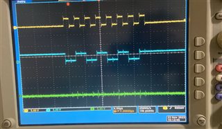

    In all the trials of combinations, we can see only 8-clock cycles in Waveforms while we were transmitting 8 different data’s and we have configured for 8-bit word.
    So, Please support us in how we can see more than 8 clock cycles.  For example, here I am transmitting 8-different data’s and we want to see (8-bit X 8) totally 64 clock cycles consecutively and Chip select (CS) should keep to low.
    Thanks & Regards,
    Chaya
  • Hi Chaya,
    Thank you for the scope shots of the testing. I also wanted to ask if you could clarify that the yellow is SPICLK, Green is SPISTE nd what is the blue signal (and what was the purple in the prior scope shots?) to be sure. Are you scoping both data lines to ensure that the correct data is being sent from both the F28335 and HI-35850 on each line during the time?
    Also, I see that you are writing to the TXBUF for several lines of code in a row without a break, could you try adding in some delay between writes? Or have you considered using FIFO mode?
    Also, are you manually setting the SPISTE pin low at the beginning of data transmission and then setting back high at the end? This would ensure you are capturing the time that data is being sent.
    Allison
             Thank you for your response.
             We have tried configuring the SPI for TMS320F28335, now we are getting 16 clock cycles and Chip select is also low as excepted..
            One more query we have on this, Now I am integrating TMS320F28335 and HI35850 and trying to communicate between Host SPI (TMS320F28335) and HI35850, I have configured TMS320F28335 for Mode 1 and as Master, but I am not able to see the communication between them. Please help us with this.
    We have a few query about this, Can we have a call regarding this issue.
    If yes please tell me your availability time to connect through Teams
  • Hi Chaya,
    Glad you resolved the issue - I'd like to clarify a few things before trying to set up a call:
    • What exact change did you implement to resolve the issue? Was it changing the clock mode to 1? Or add code to pull STE low and then high?
      • And instead of 8 clock pulses, you now see 16 in a row with no delay?
    • Are you able to provide scope shots of the 4 SPI lines during attempted communication? (SPICLK, both data lines, and SPISTE)
      • This is very helpful in debugging SPI communication issues as it can be quite apparent if one device or the other is not transmitting or receiving properly.
      • I also ask this because if this seems to be a HI35850 related inquiry, we should try to reach out to experts with that device as I my knowledge is on F28335.
    • I think I may have misunderstood the original issue, as I had thought that you were able to communicate between the 2 devices, but unable to communicate the full data- could you clarify what the other oscilloscope channels were in the prior images you sent?
    Allison
