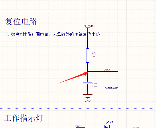

At the beginning, it can still be DEBUG, but after flashing a few times, it cannot be flashed and locks up
I have already replaced three chips, and the situation is the same
The board I am currently using is powered by a power supply simulator and burned
NXRS has interference here, I don't know where it came from
Confirming that the flash has been constantly resetting, I feel like the RAM has not been tested yet, and the peripheral hardware has been reset normally. I also replaced the capacitor in the circuit with 100NF, but it still cannot be reset. Let's see how this problem occurred and what is the solution?

    What do you mean by power supply simulator? Please elaborate on the above details.

    If you put the device in Wait boot mode can you connect over JTAG?
    What kind of noise do you see? Can you capture and show waveforms of the signal and issue you see.
