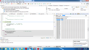

    I want to share some steps i have have done and have some questions regarding the same,

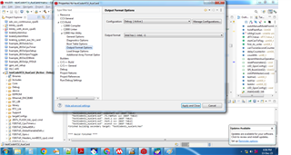

    Note: There are two projects of led blinking, a) 300ms led blinking for eeprom b) 100ms led blinking for controller
    A) Dumping hex file in external eeprom
    => 300ms led blinking code (hex file) to be dump inside external eeprom
    => Before dumping i have set some settings in properties-> C2000 Hex Utility-> Boot Table Options -> set a) Select boot mode, b) SPI-A port, 8-bit mode(--spi8, -spi8)
    => Output format Options -> set 'Intel hex'
    => Building the project
    => When reading this hex file, i can see the key = 0x8AA in first two bytes
    B) Standalone Boot
    => Debug Configurations-> Target-> Flash Settings-> Z1-Bootctrl(0x7801e) = 0x0000045A
    => After building -> debug mode
      as you can see the value of z1-bootctrl in memory browser
    => CPU Reset
    => Resume
    => Pause
      as you can see the value of bootctrl register is not changed, and the controller code is running instead of eeprom code
    => You can see Boot Status Registers as well, as there is flash boot in the register value, instead of spi boot
    => I Think the controller is not getting into spi boot, because the address i am setting the value (0x045A) is not wrong address you provided in TRM, because as you can see in memory browser below the address is 0x0005F004 instead of 0x7801e, and if 0x0005F004 is the correcet address for setting the bootctrl register then please tell me how to do it, because in flash settings of target in debug configurations the address is 0x7801e
    => And one more thing do i have to set the other register as well in flash setting, refer below picture
    NOTE: I done power reset my controller board in standalone boot as well, but controller code is running instead of eeprom code

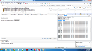

    B) Emulation Mode
    => Setted the value 0x045A in register 0x00d00 in debug mode
    => CPU Reset
    => Resume
    => Pause
    => Even in emulation mode controller code is running instead of eeprom code

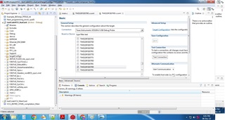

  • Hi Allison,
    The steps you mention above for emu booting didn't work for me.
    1) In toolbar->Scripts->EMU Boot Mode Select->(EMU_BOOT_SARAM & EMU_BOOT_FLASH), but i want EMU_BOOT_SPI, which is not showed in that option.
    2) Even though i have manually put the value 0x045A on address 0x00d00 in memory browser, in cpu reset state in debug mode, and hit resume, but it runs the controller code and eeprom code. (NOTE: I have already done this and given you the screenshot in previous reply)
    Best Regards
    Saddam

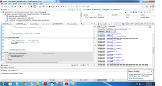

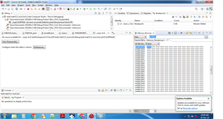

  • Hi Allison,
    All the steps you mentioned works perfectly fine, and yes i am able to establish the SPI communication between external eeprom and controller, because in SPI_start_Boot() i can see it is reading the key : 0x08AA, which means spi is working and returning the entryAddress(Decimal :545171).
    But when i run resume after getting the entry address, it doesn't run the eeprom code, it still runs the controller code.
    Screenshots for your reference are as follows:
    1)After completing the spi_boot() function which returns entryAddress, and i am going step by step till the exitBoot, and pressing resume, then code goes nowwhere(refer pic 4)):
    1) 2) 3) 4)
    Saddam
  • Hi Saddam,
    Thank you for posting the details of stepping through the SPI Boot process, I have a few questions and suggestions.
    1. Does the entryAddress returned by cpu1brom_system_init() agree with what you see in the Memory Browser? I would expect the application to be programmed at 0x80000, as stated in section 4.10.1 of the Technical Reference Manual. Is the 0x80000 address occupied by other data? If so, please use the On-Chip Flash tool to erase Flash memory before programming.
    2. I noticed that you used the Intel Hex format when generating the hex file for the LED blinking application. Please use the ASCII Hex output format (-a or --ascii) to generate the hex file. See section 4.10.5 of the Technical Reference Manual for more details.
    3. I am not sure I understand what behavior you are seeing after the application is loaded into Flash. Earlier you said that it runs the controller code instead of the EEPROM code, but in the screenshots you mentioned that it doesn't go anywhere. What controller code is running? Are you loading a program onto the controller before SPI_Boot takes place?
    Kind regards,
    Skyler

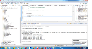

  • Hi Skyler,
    1) You can see in the screenshot, the address is 0x00085193, this occured when i followed allison steps
    2)It should be intel hex(i think), because when i read the ASCII hex file i don't see the key (0x08AA) on first two bytes and later on, but i can see the key and other things like baudrate in intel hex file.
    ASCII Hex file
    Intel Hex file
    3) You can see in the screen shot in my above response, In Debug Mode i can see my code running that is led blinking, but when i pause the program then that nowwhere thing appears(refer the screenshot in previous response Pic 4).
    Best Regards
    Saddam

    4) i was not able to send you the .cmd file, hence i have provided the screenshot of the content of the file.
    fig1) fig2)
    fig3) fig4)
    Saddam

  • Hi Skyler,
    first let me clear that there are two codes : one for eeprom(led blink 300ms) and other for controller(led blink 1s).
    1) I have programmed the controller via controller code and set in debug mode, then done cpu reset and then loaded symbols : "C:\ti\c2000\C2000Ware_2_01_00_00\libraries\boot_rom\f2837xd\revB\rom_sources\ccs_files\cpu01\Release\F2837x_cpu01_bootROM_REVB_Golden_020314.out", and done further steps as guided from Allison in above messages.
    2)
    To load the symbols, pause the debug session after the LED application has successfully been loaded, navigate to "Load Symbols", and select the .out file corresponding to the LED Blinky application project
    I didn't get by what you mean in this quoted message, do you want me to load the .out file of eeprom code or controller code?
