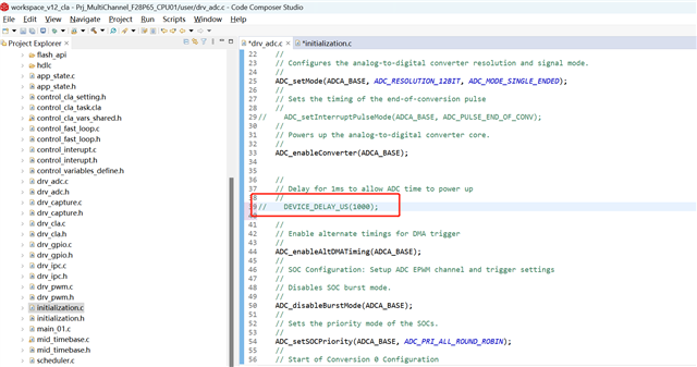

issue 1:  the code " DEVICE_DELAY_US(1000);" in setup ADC function will cause project to enter "Intterrupt_illegalOperationHander" after running.

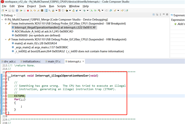

issue 2: after I delete code" DEVICE_DELAY_US(1000);" the function ADC_ISR will cause "Intterrupt_illegalOperationHander." after CPU02 start to run.

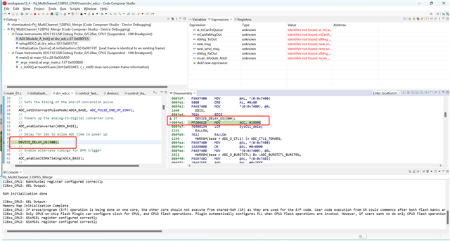

    Since you're starting with an example project, it looks like you should have all the right paths and libraries included; are there any warnings you get when compiling the project? Are you able to step through your code and get into the delay function at all? If not, please provide a screenshot of the Disassembly view so I can see what the compiler created.

    Are you able to isolate the location where the illegal ISR gets jumped to? Is it a certain point in your code? If you don't know for certain, you can always use the RPC (return program counter) register to see where it jumped from and keep backtracking from there using breakpoints.

    the screenshot of disassembly view is below when "Intterrupt_illegalOperationHander" caused by "DEVICE_DELAY_US(1000)";:

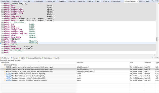

  • And the screenshot of warning after compiling the project is below:

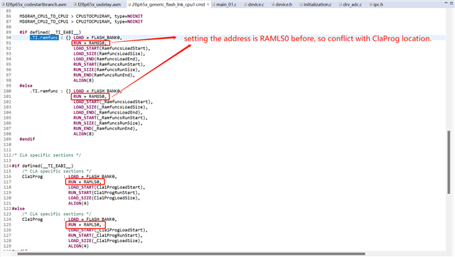

     I have found the root cause, as the setting of CPU01 ".TI.ramfunc" running Ram space is conflicting with CLA.
