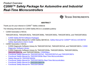

    3. In section 7.11 of databook, it said  C2000 Safety Package for Automotive and Industrial Real-Time Microcontrollers User's Guide has some more information of LCM self test. But I don't know which article should I refer in these user guide.
    The two highlighted items below show the available safety collateral for F280015x
    Vince

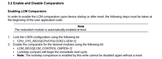

  • 1.Figure3-1 in TRM is blew. I what to know, how can I choose the primary/secondary module (like DMA)? Or the  primary/secondary module is just CPU?
  • Hi Liu,
    There is no DMA on F280015x, it is mentioned as a general statement for all devices with LCM, where the DMA may have a redundant module too (no devices exist with this at this time). The only LCM option that is available on F280015x is the CPU.
    Vince
