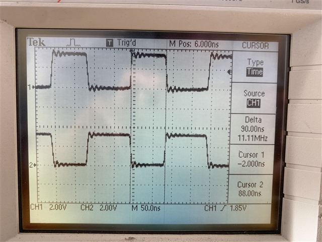

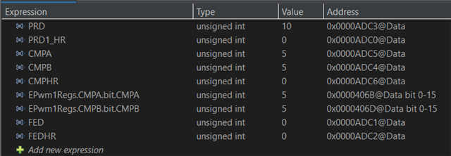

Hello every one, I code on ccstudio, a TMS320F28379D. I want to create a high resolution PWM signal with exactly 50% duty cycle.
So I configured my PWM in high period resolution and CMP in UP/DOWN count. The PWM calculations and singal work very well for all period values  (208ns, 210ns, 220ns) and I'm well within 50% duty cycle.
An error appears in the signal when the period admits no HRPRD (TBPRDHR=0) and when the CMP=PRD/2 exactly, but only when my code is launched.
Ex : 200ns -> PRD= 10 and CMP = 5 = 10/2 (same with 240ns etc). I observe a decagle of +/- 1 TBCLK (10ns) for the duty cycle. But the curious thing is that when I modify the value of the period in real time at any period (ex. 208ns) and I change again to 200ns, the duty cycle  is 50% and the +/- 1 TBCLK is no longer present. But when I look at the PRD, CMPA, CMPB and CMPHR values in real time they are the same value for the first 200ns period and the 3rd period value (200ns) (screenshots 1 and 3) but we observed  a +/-1 TBCLK.
I don't see where this error comes from. And this error is present only if the first period value is equal to 200ns, 240ns or other period with CMP=PRD/2 exactly. But not for other period values (ex 208ns, 220ns etc).
Here are the photos and screenshots different values (PRD, CMPA etc) shot for 200ns then 208ns and back to 200ns with a dynamic value periode:
The code is launched with 200ns (duty cycle set 90ns ) :
       1.
Je modifie la valeur de periode pour 208 ns (duty cycle : 104 ns)  :
         2.
I set again a period of 200ns (duty cycle : 100ns) :
    3.

  • Hi Florentin,
    To clarify, are you seeing +/- 1 TBCLK jitter on your HRPWM output? I do not recognize the 'decagle' terminology here. There may be a few incompatible HRPWM settings here, which can lead to abnormal HRPWM outputs. I will take a better look at the code tomorrow, but the first thing I noticed is your loading scheme. If using TBPRDHR control, please be sure the CMPx and CMPxHR shadow load modes are set to load on 'ZERO AND PRD'. Also, what are your specific TBPRD, CMPA, and CMPB values that are normally set when you are seeing the issue occur?
    Allison Nguyen
  • Hi  Alison,
    I observe a +/-  1 TBCLK when I run the program with a specific period value. If the number of TBCLKs is divisible by 4, here's an example with 200ns: it takes 20 TBCLKs to complete this period, so TBPRD = 10 and CMPx = 5. Here TBPRDHR = 0 and CMPxHR = 0 (works with 240ns, 160ns etc). This is where an error of +/- 1 TBCLK occurs. For the term "decaglec", it's an error, I meant an offset.
    But this +/- 1 TBCLK error disappears when I dynamically change the period value (to  208ns) and then reset the initial value (to  200ns).
    I have just changed the loading mode to 'ZERO AND PRD' and the error is still present when the program is launched.
    Thanks for your help.
  • Hi Florentin,
    Thank you for the helpful information. CMPxHR = 0 values are actually not supported; when CMPxHR values are set to 0, this can cause the 1 TBCLK jump in signal you are seeing.
    As a side note, developing using the SysConfig GUI can also help here as there are warnings and errors to catch some of the incompatible settings such as in this case if you plan on utilizing it in the future.
    Allison
  • Hello Allison,
    I have indeed changed the calculation of CMPHR to CMPHR+1 to avoid the case of CMPHR = 0 but I still observe the +/-1TBCLK during the program launch.
    And thanks for the tip, I'll have a look at the SysConfig.

  • Hi Florentin,
    This helps a lot for sure there is likely some particular setting causing the issue. A few questions for you:
    • Are you writing the same CMPAHR and CMPBHR values when you set them?
    • Can you try using TBPRDHR set to the same value as CMPAHR and CMPBHR?
    • Can I ask why you are using CMPA and CMPB as your Action Qualifiers? Are you able to try using just CMPA-up and CMPA-down to center around PRD?
    • Can you check to make sure that TBPRDHR is being initialized to any value other than 0?
    Let me know if you are able to answer these questions or see resolution of the issue in doing so. Have you had a change to try out SysConfig at all (no worries if not)?
    Allison
  • Hi Allison,
    Thanks again for your help. Yes, the values of CMPAHR and CMPBHR are the same and I modified my code to also have CMPA = CMPB. So I set the AQ to CMPAup and CMPAdown. But I must  set CMPB otherwise the Epwm1B signal is not stable when Dead Band is activated.
    Concerning Sysconfig, I tried to use it in my code, I have several error and complucation messages. I'll look into it later.
    And for TBPRDHR, I modified its value when TBPRDHR = 0 and added + 1. This solved my problem. All period and duty cycle values are as expected.
    Thank you very much for your patience and your help.
    Florentin
