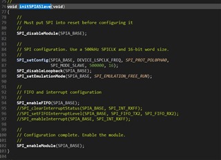

Hi, I'm trying to establish a SPI communication between two 28379D Launchpads. I have configured one as a Master and one as slave. When I execute both of them, I see that the received data in the Master launchpad is very random, it sometimes shows the value from the slave, sometimes directly the sent data on the MOSI line. I'm trying to use the CPU timers for executing the SPI write and read as I need them to be executed at a specific time interval. I have attached the code I have for SPI master setup and the write and read commands in the cputimer interrupt. How do I resolve this issue?
