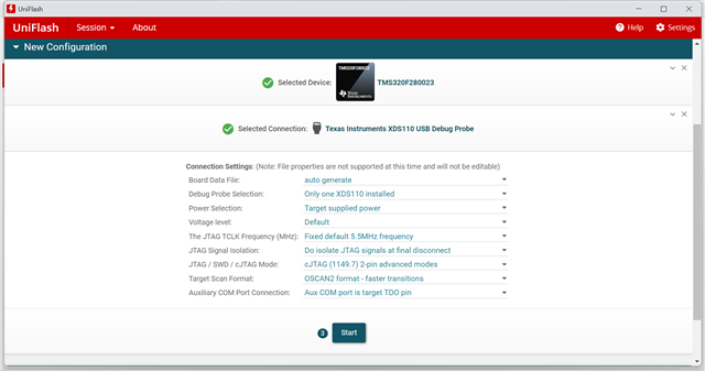

I am using the following configuration settings for the session:
Using the same settings, I tried flashing my image on the evaluation kit (F280025C controlCARD and TMDSHSECDOCK - Docking Station) and I was successfully able to do so. Therefore, I can confirm that there is no issue with the image file or the connections of the debug probe and the microcontroller.
