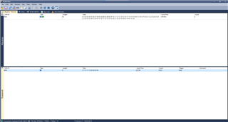

  • Hi Premkumar,
    Okay, thank you for verifying. Since we have confirmed the CCS and device setup to make sure they are consistent, I believe there could be an issue with the PEAK USB setup. What is the clock frequency of the PCAN USB FD device? Below is a screenshot of the settings used on my device.
    Kind regards,
    Skyler

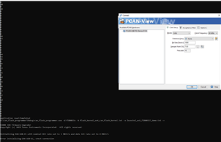

  • Hi Skyler,
    I have checked by setting the configuration for PEAK USB setup, that you have mentioned above, when I am setting that configuration and loading the file it is showing error . when I am setting clock frequency as 20MHZ, and bit rate as 1Mbps file is getting loaded but it is indicating red while loading.
    Please find the attachment,
    Premkumar. T
  • Hi Premkumar,
    You are correct, it should be 20MHz. I didn't realize the system reset on my end to show 80MHz. I will reach out to you offline to schedule a call so we can resolve this.
    Skyler
