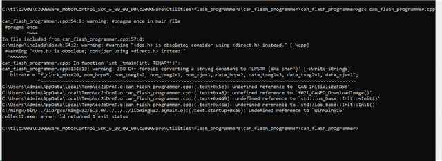

  • Hi ,
    Thanks for your reply.
    Could you please elaborate on which parameters need to change on the .sln file for F2800157?
  • Hi Shankar,
    Within the can_flash_programmer.cpp file, the following parameters need change/addition: Device name (bool g_bf280015x = false;), bitrate string, sleep_time, setDeviceName
    Charles
  • Hi ,
    Tried the same suggestion mentioned in the previous comment But still facing issues with .exe generation.
    Some definitions are missing it is showing but those definitions are there inside the include/source.
    Need your support to proceed with this further
    Shankar
  • Hi Shankar,
    The .exe is generated through recompiling the project solution (.sln) using Visual Studio for Windows.
    Charles

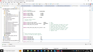

  • Hi Premkumar,
    Based on your screenshots, it looks like MCAN_Boot is undefined. Have you defined MCAN_Boot? If so, are all the proper header files included in the flash_kernel_ex_can_flash_kernel file?
    Kind regards,
    Skyler
  • Hello Skyler,
    Thank you for your response.
    I added the flash_kernel_ex_can_flash_kernel file. I am getting the same error.
    Premkumar.T
  • Hi Premkumar,
    Is MCAN_Boot() defined? In the example project, it is defined in MCAN_Boot.c. I am unfamiliar with your project structure, but it looks like you need to define the symbols the compiler is indicating are unresolved.

  • Hi Skyler,
    On the extern void CopyApplication(MCAN_RxBufElement rxMsg);
    Kindly find the attachment of the project structure and error log.

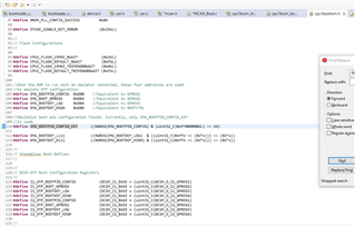

  • Hi Premkumar,
    Is this argument being passed to the Fapi_initializeAPI() function? If so, you should be passing the FlashTech_CPU0_BASE_ADDRESS macro defined in the flash_programming_f280015x.h file.
    Kind regards,
    Skyler
  • Hello Skyler,
    I added Base address for F021_Cpu0 and defining all the parameters. I am facing a following new error.
    Thanks and Regards,
    Premkumar.T

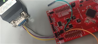

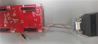

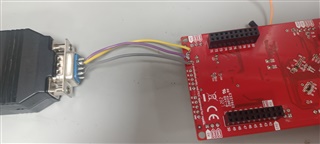

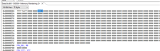

  • Hi @skyler Baumer,
    We are successfully able to build the code for F2800157 but still have some doubts about the build.
    1)After connecting PCAN-USB it complied successfully but looks like no code is flashed.
     Don't know if this is flashed or not.
    The updated code is attached here for your review. if anything is needed please let me know.flash_kernel_ex_can_F2800157.zip

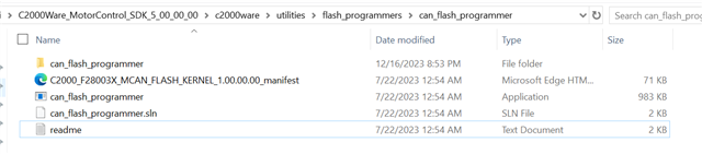

  • Hello Skyler,
    Thanks lot for your support. Now we resolved the build error, we can able to without error.
    While flashing via CAN can_flash_progragrammer.exe is not recognised error I am getting.
    Please find the attachment of following error.
    Thank & Regards,
    Premkumar.T
  • Hi Premkumar,
    The executable is located one level back if your project mirrors the C2000Ware setup for Utility->Flash Programmers.
    ex. \can_flash_programmer->can_flash_programmer.exe
    Can you change the directory path?
    Thanks and regards,
    Skyler

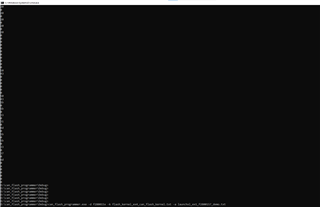

  • Hi Skyler,
    Thank you for support. After changing the path i am getting Unable to open kernel file flash_kernel_ex_can_F2800157.out. Does it exist?
    Pleas find the attachment.
    Thanks & Regards,
    Premkumar.T

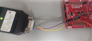

  • Hi  Skyler,
    After changing path and adding files .hex and .out, it is not showing any error but that kernel file is not loading.
    Please find the attachment.
  • Hi Premkumar,
    For some instructions on how to use the can_flash_programmer, please refer to this document: www.ti.com/lit/sprad51
    Thanks for your Reply.
    We checked and enabled the hex utility for Kernel build files
    But still, Ccs studio generated .out files only and not generated hex files.
    Even tried the same for the existing working project F28003x also the same issues CCS generated. Out files but not hex files.
    This issue we faced only for Kernel project files, not for other project files.
    Meanwhile, Shared updated the Kernal build project to a private message could you please review it and let us know?
    Thanks for your extended support

  • Hi Skyler,
    I am trying to flash the application file with the command [can_flash_programmer.exe -d f280015x -k flash_kernel_ex4_can_flash_kernel.txt -a launchxl_ex1_f2800157_demo.txt]. It seems to be that, application is loading, but it is not flashed in the controller.
    please find the attachment,
    Thanks & Regards,
    Premkumar.T

  • Hi Skyler,
    When the CAN communication is taking place, is the PEAK-USB device blinking red. There is no indication for kernel file loaded and application file loaded, also  while printing it is taking a pause for some time and again it starts printing. In the document I have found to set the data bitrate for 2Mbps. After checking for the timing issue also, while transmitting the PCAN USB device is indicating red.
    Premkumar . T
  • Hi Premkumar,
    To see more information during the execution of the host programmer, add the -v option to your arguments. Example: can_flash_programmer.exe –d -k -a -v
    This should allow you to discern between the kernel load and application load. The pause in the host programmer execution takes place after the kernel is sent to the F280015x and it is allowing time for the device to boot before sending the application. The PCAN USB device should not be blinking red during the kernel load. If it is, there is likely an error in the GPIO configuration. What configuration are you using? Are you using the Launchpad (LAUNCHXL-f2800157)? Are you using emulation boot mode for this?
    Kind regards,
    Skyler

  • Hi Premkumar,
    Thank you for the information! Are you setting the EMU_BOOTPIN_CONFIG and EMU_BOOTDEF registers in the Memory Browser? For MCAN, you should enter 0xFFFF at 0xD00, 0x5AFF at 0xD01, and the corresponding definition in cpu1brom_boot_modes.h that uses GPIO 4 and 5 at 0xD04. Based on your screenshots, it looks like you have changed the the default GPIOs corresponding to the different Boot Modes. Therefore, you should enter whichever value corresponds to MCAN_BOOT_SENDTEST at address 0xD04 in the Memory Browser. If using the Boot Modes and cpu1brom_boot_modes.h file from the bootROM code in C2000Ware, you would enter 0x88 at 0xD04 to use the MCAN_BOOT_ALT1_SENDTEST Boot Mode that is mapped to GPIO 4 and GPIO5. After setting these values in the Memory Browser, reset the device via the XRSn and start the host programmer.
    Kind regards,
    Skyler
  • Hi Skyler,
    Thanks for the support,
    For MCAN, I have entered 0xFFFF at 0xD00, 0x5AFF at 0xD01, and 0x88 0xD04 in the memory browser, After setting values in memory browser i have done reset via XRSn and clicked on resume, then I have entered command [can_flash_programmer.exe -d f280015x -k flash_kernel_ex4_can_flash_kernel.txt -a launchxl_ex1_f2800157_demo.txt -v] and I have checked the values are not getting updated in memory browser, also its indicating red while file is being loaded.
    Premkumar . T
  • Hi Premkumar,
    Is 0x88 corresponding to the Boot Mode defined in your project to use GPIO 4 and 5 as CANTX and CANRX? The screenshot you sent suggests that the definitions are slightly different than what is in C2000Ware, so please verify that you are configuring the proper GPIOs. If you are using the LaunchPad and GPIO 4 and 5 make sure to set the CAN Routing and Boot Mode Select switches properly. This document will help you locate the switches: https://www.ti.com/lit/spruj54
    The CAN routing switch should be set to ON (down) and the Boot Mode Select switch (GPIO 24 and 32) should be set to 1 and 0, respectively. More information about the Boot Mode Select switch can be seen in https://www.ti.com/lit/spruiy4a, section 5.3.
    Skyler

  • Hi Skyler,
    Yes, I have checked GND, CAN-H, CAN-L of launchpad(F2800157) is connected to PCAN of 3rd pin to gnd, 2nd pin to CAN-L  and 7th pin to CAN-H.
    Premkumar. T
  • Hi Premkumar,
    Can you send a picture that clearly shows the pins of the PCAN USB Device and where they are soldered to on the F2800157? Since I am able to load the kernel into RAM using the CCS project and host programmer sent to me by Shankar and exact steps detailed above, I believe this is a hardware/setup issue.
    It is also possible that other processes on the computer you are running the host programmer on could be interfering with the communication.
    Kind regards,
    Skyler
  • Hai Skyler,
    Here, I have added the images for hardware connection of PCAN device to launchpad(F2800157).
    Premkumar. T
