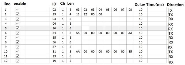

3:Results of the current code run
my LIN Schedule Table
my Exception Result
IC Receive  02 -03 02 03 04 05 06 07 08  -20ms
IC Transmit 03- 11 34 56 78 9A AB CD EF-10ms
IC Transmit 04 - AA AA AA AA AA AA AA AA-90ms
my Actual Result
Q1 : Based on Head 0x03 and 0x04 reply Message, the actual result is Head 0x04 followed by Message error,Head 0x16 followed by 0x04 want to send Message, what is the way to solve it?
Q2: How can the code configuration be modified to implement the function of sending and receiving LIN data with a single interrupt?
