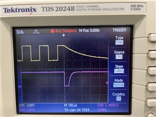

Hi Team,
hardware: F2800157 CC
software: C:\ti\c2000\C2000Ware_5_01_00_00\driverlib\f280015x\examples\gpio-->gpio_ex2_toggle
I changed the GPIO toggle frequency from 1s to 100us for observe easily.
I just add watchdog by syscfg(The default mode of watchdog is reset mode):
But the device can not reset properly.
I observed the device pushed the XRSn pin low about 50us. But the program can not run after reset, and PC pointed to this place:
CH1 Yellow GPIO
CH3 Purple XRSn
Should I take some other operations of watchdog or other modules for properly reset?
Thanks & Regards
