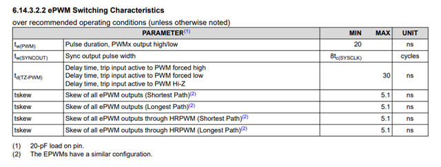

    This information is provided in the following table in the F28P65x datasheet:
    Let me know if this answers your question.
    Thank you,
    Luke
  • Hello Luke-san.
    Thank you for your response.
    However, it seems that the answer I'm looking for is different.
    Nima Eskandari-san replied:
    "Each XBAR is async and has an approximate 2-3 cycle delay. Since you are going through 2 XBARs, around 40-50ns delay is about correct."
    I would like to know if the datasheet mentions Input X-BAR and Output X-BAR delays, not ePWM delays.
    Best regards.
