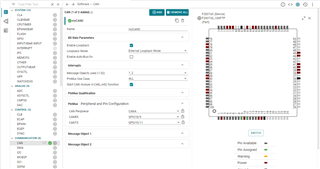

Currently, I am doing "can_ex1_loopback" example but I can not success to read the data. Below is my set up.
And this is my Watch Variables
Please help me resolve the issue.
Thank you.

Please download my Application report http://www.ti.com/lit/SPRACE5. and look at the Debug tips provided. Most CAN issues can be resolved by going through this checklist. I have also created a video to help with the first communication project using DCAN: https://training.ti.com/getting-started-dcan-module. Please take a look.
Consolidated resource list: https://e2e.ti.com/support/microcontrollers/c2000-microcontrollers-group/c2000/f/c2000-microcontrollers-forum/1033069/faq-what-kind-of-resources-does-ti-provide-to-help-with-can-and-canfd
"Can I ask you one more question, whether it's possible to communicate between eCAN and DCAN."
Yes, both eCAN & DCAN are compatible to the CAN protocol standard. They can communicate with each other and also to any device from any manufacturer with a compliant CAN module.
