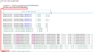

"I am involved in current control of an inverter, and I have created a code called 'daOut' to monitor internal variables. However, I have noticed significant differences in the current control characteristics when placing the 'daOut' code above and below the ADC register-related code inside the Interrupt Service Routine (ISR). In my understanding, I believe that the ADC-related code should take precedence at the beginning of the ISR. However, I have heard that some intentionally include dummy code before starting the ADC. Could you provide an explanation for this?
    Can you provide more details on the differences?

    "I am aware that to read accurate ADCResults, I need to secure the Sample and Hold time (tSH) and Latch time (tLAT). In the specifications I am currently using, tSH+tLAT is 425ns. Therefore, I conducted three experiments using DELAY codes before reading the ADCResult values.
    1. Without any delay
    2. With a delay of 550ns (sufficient time secured)
    3. With a delay of 800ns (more time secured than Case 2)
    I know that without securing tSH+tLAT, reading ADCResults retrieves the existing values. Indeed, Cases 1 and 2 show a difference of one sampling. However, the strange aspect is Case 3. If tSH+tLAT is secured, ADCResults should be the same in Cases 2 and 3, but the values are different. In Case 3, it appears that the sampling delay of ADCResults is less than in Case 2. What could be the reason for this phenomenon?"
    Deokyong

    I'm sorry, it's not clear to me the exact circumstance for the issue. Can you show me your code (you can exclude any proprietary info if needed)? Where is this delay being added? It may be the case that it's causing an interrupt overflow for the ADC, depending on its location. Are you using an example ADC ISR provided by a TI example (if so, which one so I can refer to it)?
    Can you clarify, are you saying the delay is not working properly or the ADC result itself is less than expected?

    I'm using ti example ADC ISR.
    CC ISR is also used to control the inverter current, and both ISRs are synchronized to the up-down count of ePWM1.
    For current control, CC ISR must read the ADCResults value.
    Here, in order to secure the ADC's samp and hold time and latch time, a delay is inserted at the first point of CC ISR start.

    There are 14 ADC examples for this device, you need to tell me which one you're referring to. What did you change from the example to your own project?
    From this I interpret that you're only using the ePWM to trigger the ISRs, not the ADC SOCs, is that correct?
    Have you verified that there are no overflows by checking the ADCINTOVF and ADCSOCOVF1 registers?
  • The ISR is synchronized to ePWM and begins reading ADCResults values ​​as the ISR starts.
    Are ADC SOCs separate from ISR? I understand that when the ISR is triggered, the ADC SOCs also kick in.
    Is what I know wrong? Also, can you explain what overflows are?
    Please share your code or which exact example you're using, I cannot provide much support if I can't see what you're doing. I need to see how your peripherals are configured, how the interrupts are set, the content of the ISRs, etc.

    And, this is ISR code.
    interrupt void cc_isr(void)
        //ccTimeInit = CPUTimer_getTimerCount(CPUTIMER0_BASE);
        //CPUTimer_startTimer(CPUTIMER0_BASE);
        //daOut();  // daOut() takes about 10[us].
        DELAY_US(0.55);
        /*                         Start of ADC Sensing                     */
        AdcResults[0] = AdcaResultRegs.ADCRESULT0;     // ADC01     : Ias_gs
        AdcResults[2] = AdcaResultRegs.ADCRESULT2;     // ADC03     : Ibs_gs
        AdcResults[4] = AdcaResultRegs.ADCRESULT4;     // ADC05     : Ias_c
        AdcResults[6] = AdccResultRegs.ADCRESULT0;     // ADC07     : Ibs_c
        AdcResults[1] = AdcaResultRegs.ADCRESULT1;     // ADC02     : Eab
        AdcResults[3] = AdcaResultRegs.ADCRESULT3;     // ADC04     : Ebc
        AdcResults[5] = AdcaResultRegs.ADCRESULT5;     // ADC06     : Vdc
        //AdcResults[7] = AdccResultRegs.ADCRESULT1;     // ADC08     : X
        AdcResults[8] = AdccResultRegs.ADCRESULT2;     // ADC09     : X
        //AdcResults[9] = AdccResultRegs.ADCRESULT3;     // ADC10     : X

    Here, I inserted a DELAY at the beginning of the ISR to secure the Sample and Hold time and LATCH time.
    Your ISR seems to be extremely long without even the delay taken into account. Please read section 10.7.1 Interrupt Overflow in the ADC chapter of the reference manual to understand more about checking this. You can also refer to examples provided in C2000Ware_5_01_00_00\driverlib\f2837xs\examples\cpu1\adc that give a better idea on how to configure the ADC and its interrupts for certain use-cases. Interrupt overflows should be avoided to get more accurate ADC readings.
    In general, ISRs should be as short as possible since the intention is to use them for real-time programs, where interrupts happen and are handled fast.
  • I control with a sample period of 100 us, and the total execution time of my ISR is around 50 us, providing sufficient margin. My curiosity lies in reading the ADCResults values simultaneously with the start of the ISR. Considering the Samp and Hold time and LATCH time, I added a DELAY of approximately 550 ns, and in this case, the ADC appears to operate correctly (I referred to Section 10.12.). However, when I excessively add a DELAY of 1 us, the ADC reads values differently. If no DELAY is added, the ADC reads the existing data, as expected since Samp and Hold time + LATCH time (my specification is 400 ns) are not secured.
    summary)
    1. without DELAY, the ADC reads the existing data.
    2. When considering Samp and Hold time + LATCH time with a DELAY of around 550 ns, correct values are read.
    3. Adding a DELAY of 1 us or more causes the ADC to read values delayed compared to the ePWM's Up-Down Count point.
    I believe the results of 2 and 3 should be the same.
    I see, I didn't see your ePWM configuration code so I thought you were triggering the ADC as fast as possible.
    Are you running this program in Flash or RAM? Did you use the CPU timer or DELAY_US to create the delay (your screenshot is inconsistent with the code you provided)?
    For context, running from Flash will always be slower than running from RAM, so a delay function like DELAY_US will create a delay by burning cycles which takes longer in Flash (which could cause an interrupt overflow). However, using the CPU timer counts the ticks of a separate timer from the CPU, so it should work on Flash. You should also verify the delays that you're adding by toggling a GPIO or some external signal to verify the length between each ISR trigger. Let me know if you see consistent timing by doing this.
