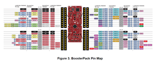

I want to use LAUNCHXL-F280049C for testing my board.
I need total of 16 PWM signals as output but in the  documentation it was mentioned that only 14 PWM signals are possible.
Can anyone please provide me information regarding the possibility of generating 16 PWM signals.
 What is the maximum switching frequency I can I acheive for my PWM signals.
Thank you,
BR
Sai G
  • Hi Sai,
    You can review the device datasheet or use sysconfig / pin mux tool to see if all 16 PWM channels are brought out onto the LaunchPad headers, I believe they should be. An alternative if some channels are not brought out is to use eCAP module for APWM output.
