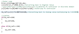

Just wanted to know, whether my above PI controller implementation is correct or not?
As of now its working fine.
You should update the yv[0].
There are PI and PID controller examples in C2000Ware or C2000 Motor Control SDK. You may refer to the example as well.
